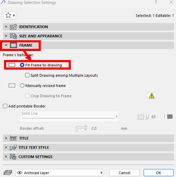

I have a window schedule that is too long to fit all horizontally on the sheet. How can I get multiple rows for the window schedule so it isn't all one line?
1 Solution
AllanP
From Archicad 26 onwards, if you have already Cropped/Resized the frame you will need to go into the
Drawing Settings -> Frame -> Fit Drawing to Frame
then "Restructure table" will appear in the pet pellet when you go to edit it.
Sometimes after placing the drawing on the layout,
you will need to Crop or Resize then frame,
then change to "Fit Frame to Drawing" ,
and then the "Restructure table" will appear.
I hope this helps.

Is this what you are after?
I hope this helps..

I haven't actually been able to find the restructure table option on the pet pallet (I use ArchiCAD 29).
AllanP
I hope this helps.
I have been using ArchiCAD continually since ArchiCAD 4.5
Member of Architalk since 2003, but missed the migration from Architalk to Graphisoft Communities. Melbourne, Australia
clauds1223
Thank you so much, you saved the day!!
