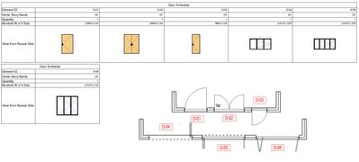

I am trying to create a modified door schedule and have only just realised the preview image that is displayed in the schedule only displays correctly when the door swings outward, rather than inward. Can anyone explain how I can make this schedule show the view from the outside regardless of the direction it opens?
To clarify, the external walls are always drawn with the reference line being on the outside face. In my head I thought it would be possible to 'show view from outside face of wall' or something like that.

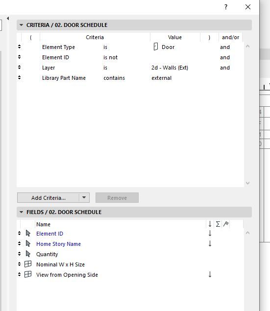

You have chosen the field "View from opening side', so you will see the door fro the side it opens to.
Maybe try 'View from reveal side'.
Hey Barry,
That then reverses the image, which doesn't help when I have a door that opens inward and outwards on the same project.

It looks correct to me.
Hmm, not working for me. You can see that D-03 and D-04 are facing the opposite direction to the other doors on the same line and these are not displaying correctly in the preview. I wonder if it has something to do with the object itself?
They are all made from the same object, but interestingly the bi-fold doors display correctly when opened outwards, however the hinged doors show correctly only opening inwards when reveal side is the nominated view.

After playing around with it some more, I think I have discovered the issue.  I was getting a similar error on the schedule when the insertion side of the door was done internally to make it open outwards too. Rather than using the "Flip" tool on the object, I was rotating the object to get it to open outwards.
As long as the door is originally placed on the outside face of the wall and I use the "Flip" tool to make the door open outwards, this displays correctly on the schedule for me.
