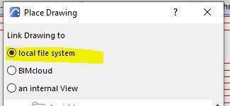

Or you can create a schedule in the mod file and upload schedules view maps  on layouts into the main file by right-clicking "Place Drawing" and then selecting "Local file system" and choose the file where you have prepared the schedule and choose view to import.
