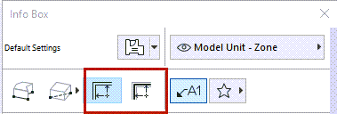

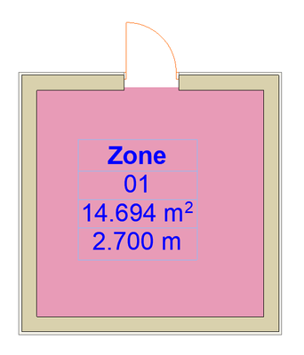

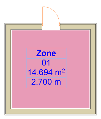

May I ask about this here too?
What should I do if the entrance does not appear in both?
Yellow color is zone
AC27 on window 11
Solution
means the door didn't recognize the Zone.
check that the Zone is Automatic and reload it. If it is manual then the edges of the Zone must include the door.
Thank you so much
I think I need to study this part more.
The wall is made in the shape of our country.
The connection between the wall with the door and the zone seems to be a problem because it seems to be up to the reference line.
Guess I'll have to re-model it... ^^
Thank you for your interest.
AC27 on window 11
A door will only come out if the zone area contains a wall.
