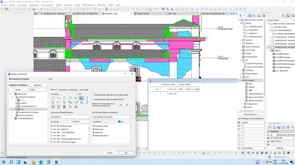

Marcelov
In lists you can extract the square footage of the fills, you can select which views this information will be extracted from.
I just wasn't able to insert this information as a table on the board with reference to the fill I'm using.
Does anyone know of anything like this!?
