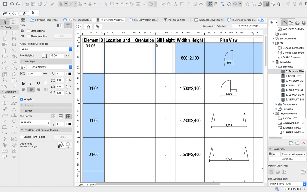

Hi, For some reason, my door schedule has gotten mixed up so that they are not shown in number order. It should below the D1- 05. Can I manually move a column ?

2024-02-12 06:51 AM
No, you can't move them because the order sorts automatically based on the settings.
Change the setting from ascending to descending in the settings.
If it now goes D5, D4, D3, D2, D1, D6 then I still think you have a space as the first character of the ID.

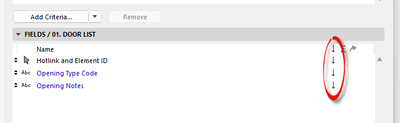

In the 'scheme settings', how do you have the ordering set.
For each filed there is the option for ascending, descending or none.
Maybe you first ID field is set to none?

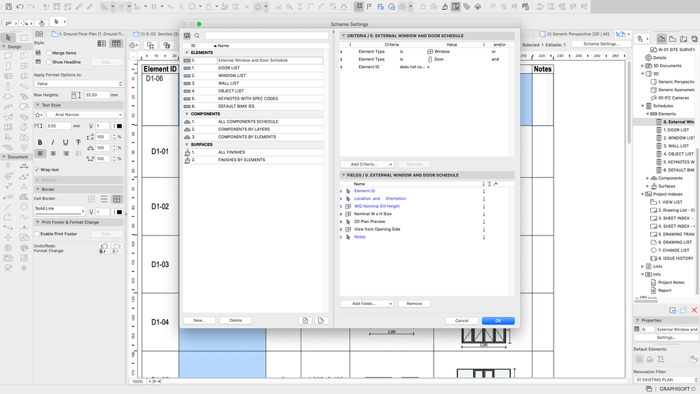

Thanks Barry for replying.
This is the scheme setting.

2024-02-12 03:18 AM
Thanks, that looks OK.
Maybe you have a space in front of some of those IDs that is affecting their order i.e. " D6-01" instead of "D6-01".

2024-02-12 05:28 AM
No, they looks fine. Am'I able to remove this(D1-06) and add it below the D1-05 again?

2024-02-12 06:51 AM

2024-02-12 08:10 AM
Thanks Barry. Sorted it out
