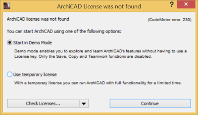

When Archicad operates normally using a hardware Protection Key, it stores the serial number of the key on the computer in an encrypted format. We refer to this data as the “Last Used Key”. When Archicad is started, but no license is available, Archicad checks if there is “Last Used Key” information available on the computer from the past 30 days, and if Internet connection is available. If those conditions are met, Archicad communicates with the Emergency License Web Service to decide if the Last Used Key is eligible for an Emergency License. If the server response is positive, then Archicad offers the “Use temporary license” option in the “Archicad License was not found” dialog that appears right after the startup screen.

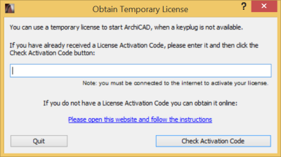

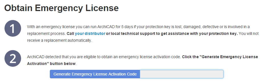

To activate an Emergency License on the computer, the user needs an Activation Code. An Activation Code can be generated on the “Obtain Emergency License” website. A link to this website is provided for the user in Archicad.
After a valid Activation Code is entered, Archicad downloads a 7-day Emergency License on the user’s computer.

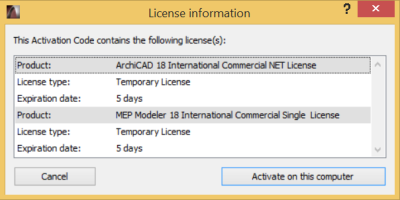

  • IT/BIM managers starts Archicad on their own computer and obtains an Activation Code. Instead of using this activation code on their own computer, they can choose to send it via email to another user, who can create an Emergency License on another computer using this code.
  • The Activation Code can be used on any computer, even if Archicad was never run before on that computer. In this case obviously the “Last Used Key” information does not exist, and the Emergency License option is not offered when Archicad starts. Archicad however can be started in Demo mode, and in the “License Information” dialog box there is a command called “Enter Activation Code” where the code can be used and the Emergency License downloaded. After re-starting Archicad, it will now run in commercial mode using the Emergency License.
