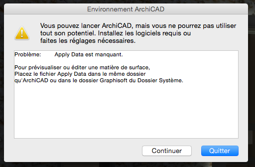

Today when i launch Archicad (17) i got a strange error message.
I never had this problem before and i don't know what file it's talking about
I'm working on MAC OSX 10.10.2
Sorry English is not my first language 😕
Thanks for your help !
The pop up say :
Apply data is missing
To preview or edit a surface material
Put the apply data file in the same folder that Archicad or in the graphisoft folder or system folder

Maybe something went wrong with the installation.
Try to uninstall and reinstall ARCHICAD. Make sure you have administrator rights to all the folders you wish to install into.

Yes it was, i reinstalled the whole thing and it's working great now, thank you !

Saw this today, the reason in this case was that I had changed the name of the Archicad.APP to another, changing it back fixed it.
