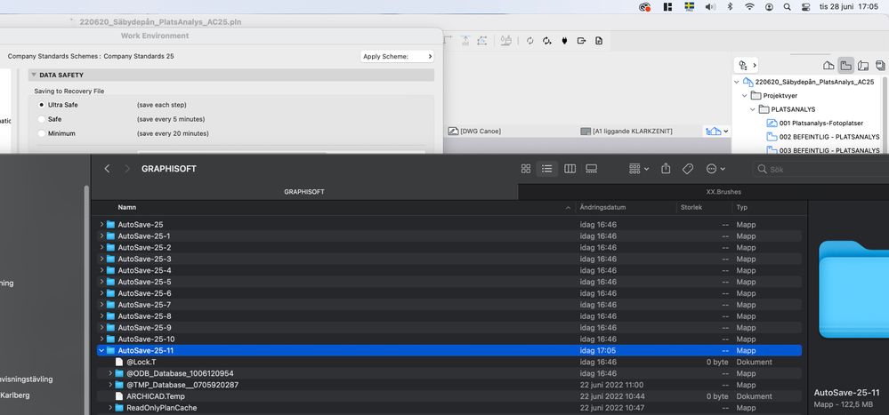

Hi I get crash and I have set like that my file be save every-each step
Why I can find only my file what was saved 1,5 before crash ?
- When I reach adres where suppose be saved crash file how can i opened ? It's not pln or pla.
Can you help me with this ?
Or which setting I have to have for this safety of my work ?

When you re-start Archicad, you should be offered to open any crashed (auto-saved) files.
You may have to close all other running Archicad before you see this.
The auto-saved files are generally not a file you can just open.
They are supposed to be pieced back together by Archicad.
However if you look through that auto-saved folder you should find a file called 'database.fdb' that has a fairly large file size.
Copy this file somewhere else and rename it and change the extension to PLN.
Now try and open it up.
I can't guarantee it will work or if all the information is there inside, but give it a try.
It is best to do it through the Archicad start-up screen though.

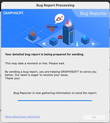

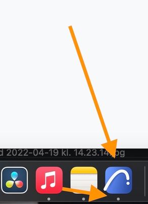

I usually close the files but the Archicad stays open and when I close it. It pops up a crash report. Because when I close file I can see small dot under icon and this mean that Archicad is stil open although i closed it.
When I do right click and close it pop up Crash report 😕
I have to say Crash report is super annoying. I cannot close and I have to wait up till 100% loading.
Honestly I never get any response from crash and this just annoying me so much
Please if you have some power to tell someone who can change it I will be very grateful.
Or can I somehow make a crash report in the background  or hide ?

There has been a problem with Archicad crashing when closing on MAC OS.
https://community.graphisoft.com/t5/Setup-License-forum/Archicad-closing-error/m-p/329122
I think this has all been fixed now.
Make sure Archicad is the latest update and you operating system is up to date as well.

You can 'force quit' the bug reporter just as you would any other program - I don't know how to do this on a MAC (I don't use them).
Saves waiting for it to go through the entire process of gathering data.
You won't hear anything back from Graphisoft, but if you do send the bug report, keep track of the bug number and contact your local Archicad support.
Tell them the number and they can track the issue for you.
