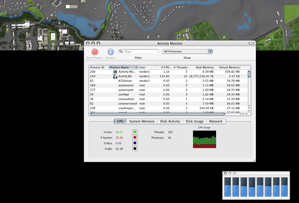

we just got our 8 core, 8GB macpro system for one reason. to be able to render huge masterplans in high resoultion, since archad always reported it's not able to do rendering because of not enough memory.
so we invested in this beast and we have serious problems.
when we are generating 3D window and archicad starts to allocate memory at the 2GB mark the activity monitor reports 16,000,000 TB. after this in most case we are not able to render anything. it just hangs up. Watching it also the "top" in x11, the memory just stops changing.
the attached picture renders, b/c i turned of some layers, but it still reports TB when hits 2GB.
So it seems like ArchiCAD cannot allocate more than 2GB. I thought even 9 could allocate 4GB of physical memory. So what is going on here exactly. We are really dissapointed.
We reported this problem yesterday to our local dealer with the file, but I don't know how fast graphisoft will respond.
I attached a screenshot.
Does anyone have similar problems?

It's not just the fact that LWS still in AC11 can't run fully the 8 cores (which at this point i don't care - although LWS claims their engine to run and utilize all cores),
BUT somewhere along the path the Intel version of 11 cannot allocate properly the memory for 3D and rendering. This is the main thing right now.
And on the other hand, there is something fishy with Apple too. Why Activity monitor reports the memory in TerraBytes and in such a large number. that is impossible. So i'm really hoping someone from graphisoft reads this issue and quickly address it or test it in such a machine.

The same file on my 2GB G5 iMac renders without any problem (OSx 10.4.10)
I'm absolutely sure that AC11 intel version is finely said (cr&$*p)
Why my 2.5 year old G5 mac renders the same model with all the layers without any memory issue? I kept watching TOP in terminal, and it seems like ArchiCAD or the OSX allocates and handle the requested memory load so smooth like knife in butter and renders my 4048 x something images with LWS painfully slow but it does it.
In the office th 8 core 8GB intel machine just freaks out when i wanna render something.
The reason we bought that beast is to get around this problem from the PC. On our pc boxes we had so many times memory not enough, hang ups on rendering. So it seems like AC11 on intel mac behaves the same way as it would be M$ windows. Sum of all. AC11 intel version for mac SUCKS and behaves like on the PC. So we should just have bought used multicore G5 for pennies and work with that.
Is it possible that the AC11 intel version is the same as the PC version except it was compiled on a Mac? What or who (maybe Apple) makes ArchiCAD crazy memory needs when you have such a system. Also why Activity monitor reports those crazy mem numbers right at 2GB memory mark when archicad allocates it...
