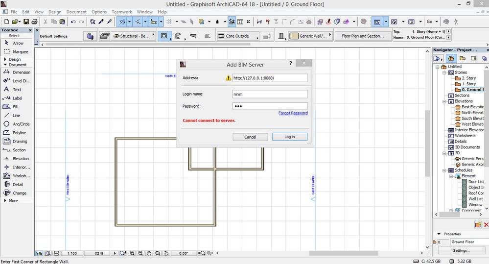

Hi ejrolon,
is there anything wrong with my BIM server setting,
also 've a problem like "mhoude" post..
thanks for advance
Irsan
Eduardo Rolon
For the installation check the Manual (Reference Guide under Help in AC) for requirements and how to set it u.
http://helpcenter.graphisoft.com/technotes/next-generation-teamwork/getting-started-with-the-graphis...
For the first screenshot you need to use the username and password you created when installing the BimServer.
For the second remove the forward slash ( / ) at the end.
Thirdly it is possible that the ports used for the BimS are blocked at your University (they are at mine) if that is the case then you need to clear it up with your IT department.
