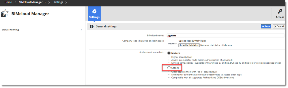

Following the instructions from this link:
https://community.graphisoft.com/t5/Getting-started/BIMcloud-Software-as-a-Service/ta-p/304068
it is not possible to log in to BIMcloud SaaS.
Is there any other instruction on GS community that I missed?

Solution
Gorazd
Hi Duje
For AC26, you have to switch to Legacy authentication in BC manager.
Gorazd Rajh
