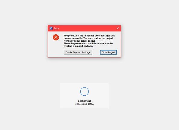

Hello everyone,
I have been having a problem for a long time and this issue affects our workflow as an office.
When another user tries to join the project I shared via BIMCloud Basic, he/she gets this error. The interesting thing is that this problem is present on some computers but not on others and this situation is not stable. The computer that has the problem can work the next day without any problem. This issue has become quite annoying. We have 9 licenses in the office and we cannot work teamwork efficiently.
We have tried many methods. We have changed the file name, re-shared the file, removed and re-added linked libraries, cleaned up local data, but this solution has been nothing more than temporary. After a certain period of time, we continue to have the same problem.

We've encountered the same issue. While we can open the BIM model with older generation Intel processors, we are unable to do so with the latest 14th Gen Intel processors

So, it seems that solution could be to update your system's BIOS. but it may or may not fix the issue entirely.
If you have guarantee for the CPU, returning it may also be an option (and getting a new one that is fixed, I guess?)
