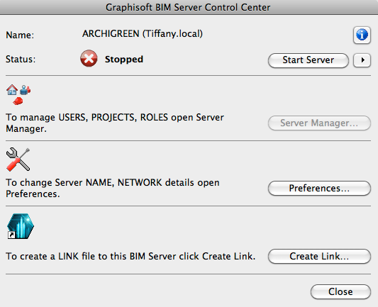

I have recently updated my MAC OSX, but now my BIM SERVER stops working.
Every time I try to start again it stops after 10 seconds.
Should I uninstall the BIM SERVER to install it again?
Any Ideas?

You said you updated your OS but have you applied the latest hotfix also?
I had similar woes after not correctly updating the BS.
Uninstalled BS,then installed and reapplied the hofix paying attention to the
installer instruction fixed a similar problem for me. All sweet now.
What gave me a clue was to check that BS was the same build number as ArchiCAD.
