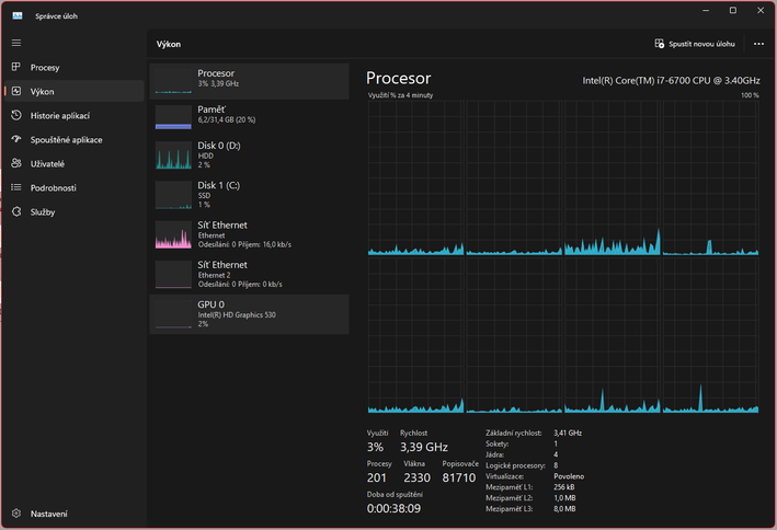

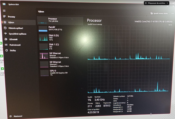

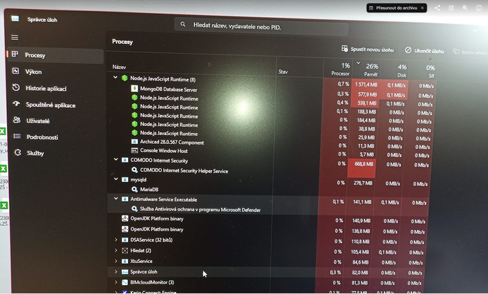

PC stats with system lag:
PC stat in fresh state, when all is running smoothly:
