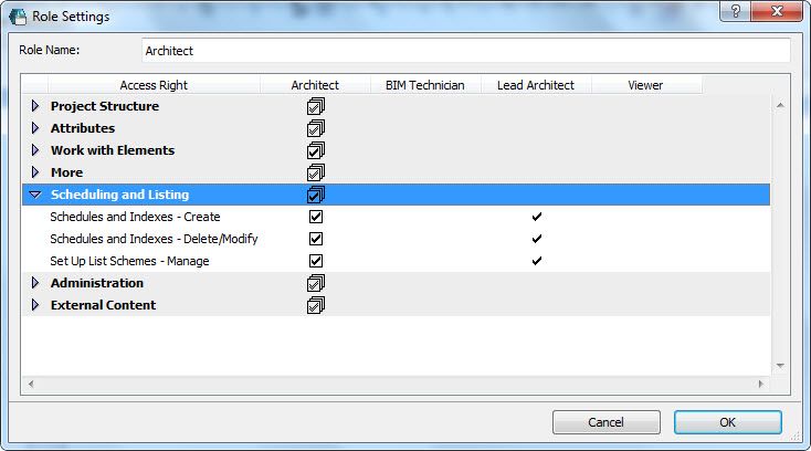

I have an interactive schedule on a TW file, and I cannot change the headers.
When I click on the field, it does not activate in order to change it...
Why?
(the schedule is in my workspace)

The schedule may be in your workspace, but does your teamwork role give you permission to edit the schedule/scheme settings?
Perhaps that determines if the header can be edited? I can quite recall without testing it. Check in your BIM Server Manager.

Achille Pavlidis
Yes, as a matter of fact, I do.
I'm "Lead Architect", and I should be able to change the schedule headers

I have seen this problem but can't remember what I did to fix it, was during crunch time for a project. Two items to try are:
1. reserving the objects that are scheduled
2. or do a reserve all for the TW project

ok, you could also try to get everyone to do a send and receive and then try to edit it before anyone does a change.
Or try it during lunch?

what is the status on this issue? Is this still affecting your projects? In similar situations a release all by everyone can help to get rid any unnecessary reservations.

Achille Pavlidis
This has been solved

Achille Pavlidis
don't really know...
at a certain point I tried changing the headers and I could...
