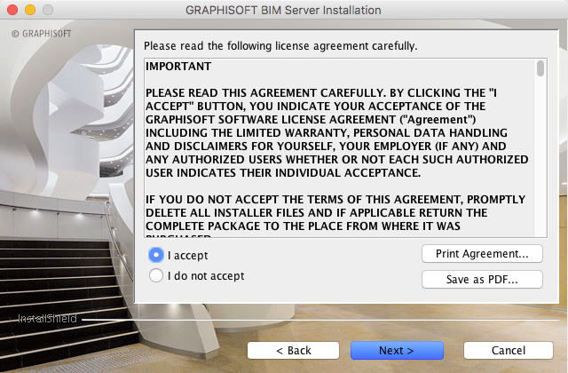

  3. License Agreement
    1. Read the license agreement carefully and accept it.
    2. Click Next to continue.

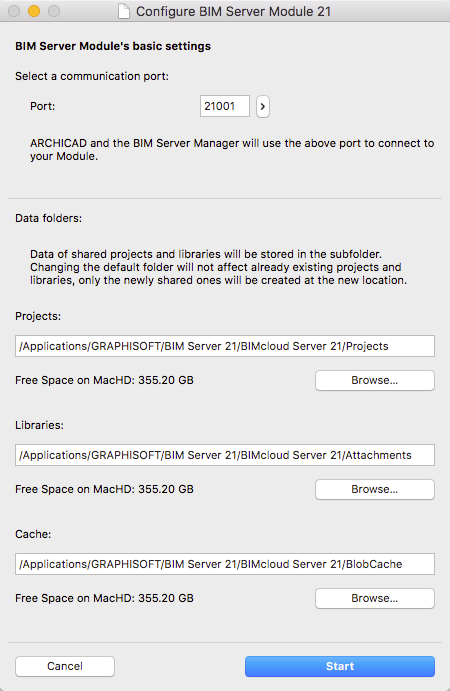

  2. BIM Server Module Configuration
    1. Port: Select a free port, or use the "Find an available port" command to automatically find one. See the default port numbers in the Network Requirements.
    2. Projects folder: Enter or Browse the location of the project data folder. This will be the location of Teamwork projects on the BIM Server. If you have other BIM Server version(s) installed, make sure to choose a different folder for the project data!
    3. Libraries folder: Enter or Browse the location of the library data folder. This will be the location of Teamwork libraries on the BIM Server. If you have other BIM Server version(s) installed, make sure to choose a different folder for the library data!
    4. Cache folder (from v20): Enter or Browse the location of the Cached data folder. This folder stores cache files from projects and libraries which are actively used. Note that the size of this folder can be really large based on the actively used projects and libraries.
    5. Click Start to continue. This will automatically open a browser window.

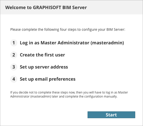

  3. Continue the Configuration in a Browser
    1. Click Start to continue.

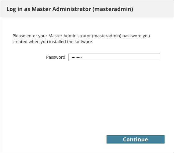

  4. Log in as Master Administrator
    1. Enter the Master Administrator password to log in to the BIM Server.
    2. Click Continue.

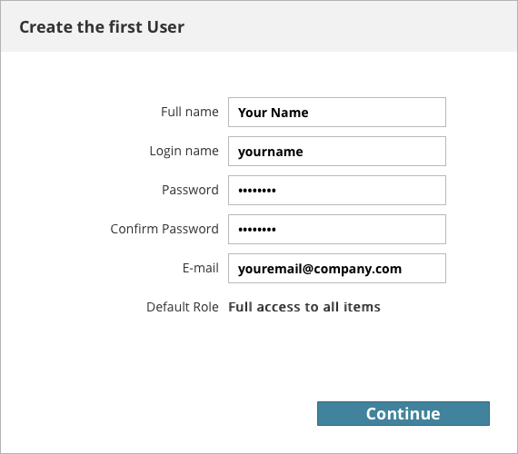

  5. Create the first user
    1. Enter data for the first user. This user will be the first Server Administrator on the BIM server. Note that the Login name is case sensitive!
    2. Click Continue.

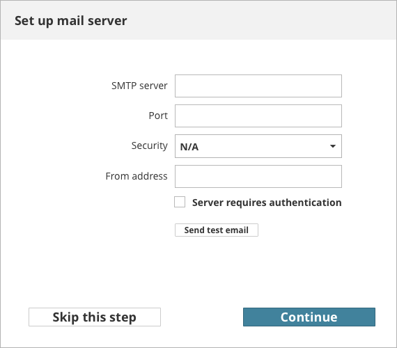

  7. Set up mail server (optional)
    1. Using a mail server is optional. However, if you do not define a mail server here, you will not be able to send emails (e.g. password reminders) to users from the BIM Server. The mail server settings can be modified or set up later in the BIM Server Manager's user interface. Click Skip this step if you want to set up later.
    2. Click Continue to finalize the configuration.

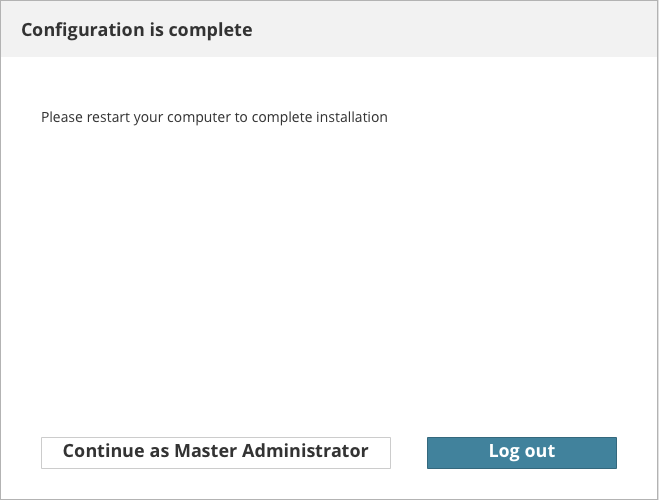

  8. Complete the Configuration
    1. Click Continue as Master Administrator to log in to the BIM Server and continue with the activation.

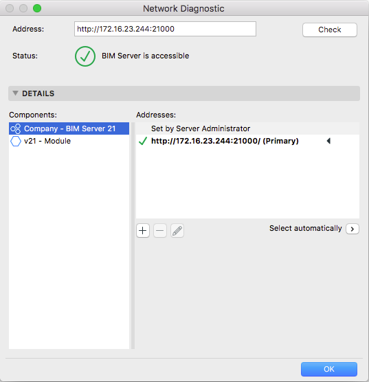

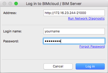

  4. Enter the BIM Server's address and the previously created user's data in the Log in to BIMcloud / BIM Server dialog then click on the Run Network Diagnostic to check the connection.
  5. Open the Details panel and select all components one by one from the Components list. Verify that all components are properly accessible. If you experience any issues, please follow the troubleshooting process.
  6. Click OK to close the Network Diagnostic dialog.
  7. Click Log in.
