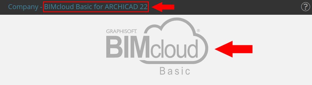

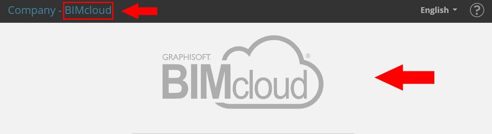

How to verify the BIMcloud product plan version
Open the BIMcloud Manager interface:
    • If the name of the installed BIMcloud includes BIMcloud Basic for ARCHICAD ## and the graphic includes the word Basic then BIMcloud Basic is installed.
    • If the name of the installed BIMcloud includes only BIMcloud and the graphic says only GRAPHISOFT BIMcloud then BIMcloud is installed.
