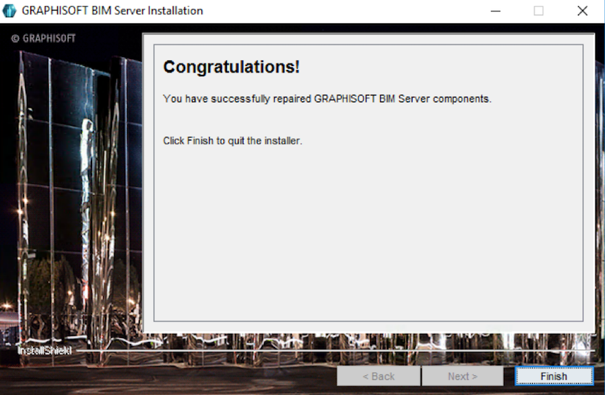

  3. Repairing Summary
  4. Complete the repairing process
After the repairing process, you also have to re-update the BIM Server to be able to use your projects.
