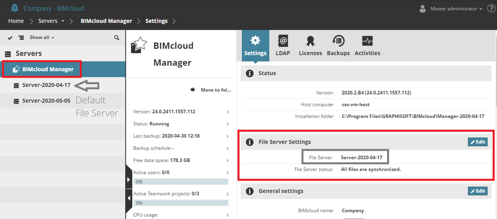

One file server per BIMcloud setup
While it is possible to pair many BIMcloud Servers to a BIMcloud Manager, only one BIMcloud Server can host files in addition to its normal tasks.

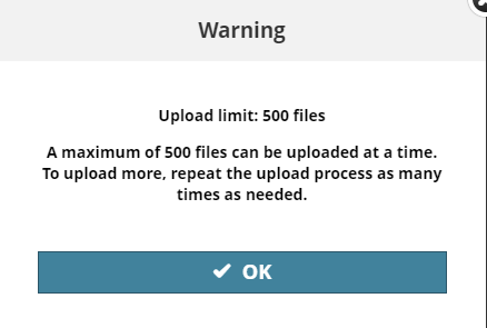

Upload limitation on the BIMcloud Manager web interface
Although Archicad can publish to the BIMcloud any number of files, the web interface upload option limits the number to 500.
If you wish to upload more than 500 files (or a folder which contains more than 500 files), you need to upload them in more steps, with uploading a maximum of 500 files in each step. Different upload batches can be started after each other - batches will be uploaded one by one. Current status of the batch uploads can be checked by clicking on the bell icon.

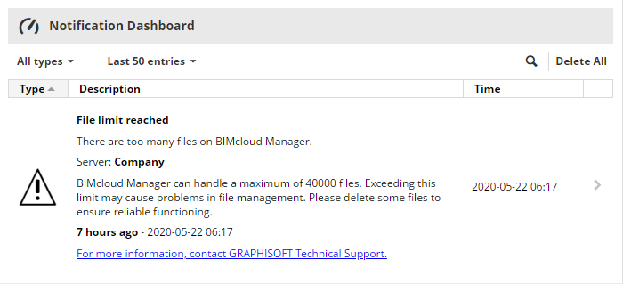

Number of files stored on BIMcloud
Above the 100 000 file limit BIMcloud's file server performance will be strongly affected, and this could have  Archicad stability ramifications.
Even if the 100 000 file limit was reached, you can upload further files up to the BIMcloud File Server. However, we strongly recommend to avoid to do so, to prevent serious performance issues which can cause you are not able to work in Archicad Teamwork.

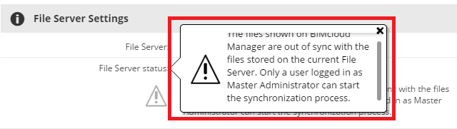

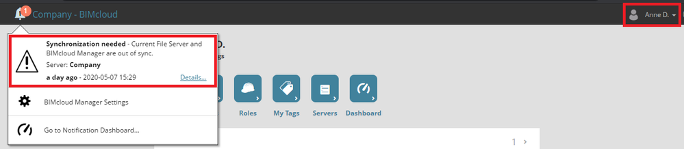

File Server Synchronization and File Server Change options are available only with the Master Administrator user
 While users with the corresponding permissions may get a notification to act, File Server Synchronization and File Server Change options are available only for the Master Administrator (masteradmin) user.
To execute these options, log in with the Master Administrator (masteradmin) user to the BIMcloud Manager.

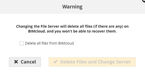

Files cannot be moved to a new BIMcloud File Server if Default File Server has been changed

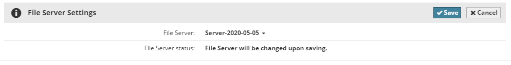

You may decide to change your current Default File Server to be hosted on a different BIMcloud Server.
If you do so, a warning message will appear to remind you about the consequences.
When you click on "Continue", you can modify the current default File Server to a different BIMcloud Server.

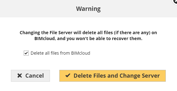

Once you selected the new File Server and attempt to save the changes, another warning message will appear on the user interface. Select "Delete all files from BIMcloud" to be able to click on "Delete Files and Change Server".

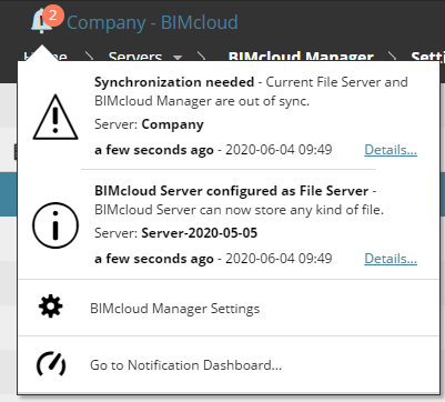

BIMcloud Manager will automatically delete all files from the existing File Server. Once the process is done, two new notification will arrive.
One will notify you that which BIMcloud Server was configured as File Server, and the other one will warn you to to synchronize your files. Both can be ignored and deleted at this point.

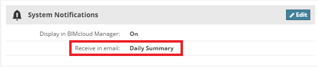

Only daily notifications are available for Subscriptions
As a new feature, available from BIMcloud 2020.2, BIMcloud users can subscribe to folders, files or BIMcloud Projects to get a notification about changes. Currently, these notifications can be sent out as an email only on a daily basis.

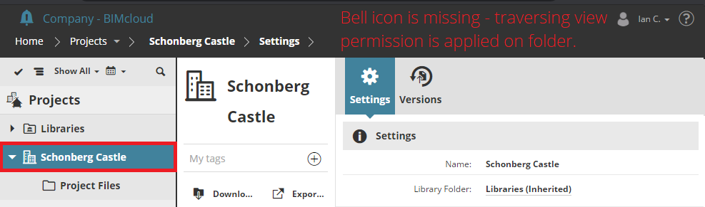

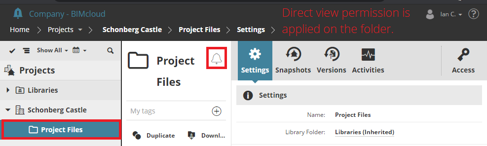

Traversing does not work for Change Notifications
Traversing does not work for Change notifications on BIMcloud. If you can see a folder only because of traversing, you cannot subscribe to that folder - you must have explicit view permissions.
