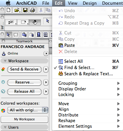

When I'm working with 1 project only everything is just fine. The Problem with the "UNDO" not being able is when I'm working with more the 1 project at the same time. Then the second project doesn't allow me to "UNDO"
And it Crashes when I attempt to drag multiple copies of an object.
Does anybody have a clue to find a solution?

I also have this problem.
Undo doesn't work on the second project when I have 2 teamwork projects running at the same time.
We've seen this problem as well... hoping that graphisoft wakes and fixes this issue...

We are getting it but it seems to be triggered by some unknown factor. Just having two TW files open doesn't automatically do it. Seems like it is triggered by something and the only way to get it back is to close down the instance having the problem and relaunch ArchiCAD and all seems to be fine again.... until the mystery trigger happens again.

Same here...
two projects open (one TW file, and one PLN file) and no undo on the TW file...
Mac OS 26.4 | AC 29.2.1 INT 5101 FULL

and here another one with the same problem...
on a mac the undo command is not working when working on multiple AC13 AUS TW files simultaneously.

We have had some success with deleting the TW Data folder to reset the local Teamwork Cache files and it seems to be working.
