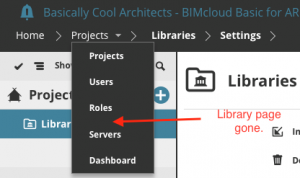

V22: Introduction to library folders

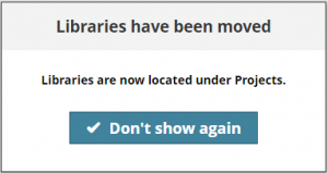

In v22, after an upgrade or new installation, the first hint of the new feature will be the note the Libraries page has moved.

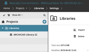

After the info dialog is closed the libraries will be found under projects.

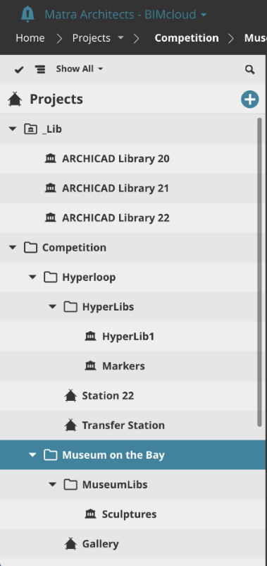

In v22 the default Libraries folder is first found on the top level of the Projects page.

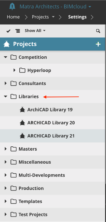

Where to find existing libraries
Existing BIMcloud libraries during the upgrade process are moved to their folder under the Projects page.  The original name for this folder is “Libraries” and it may sort into the middle of the Projects page.

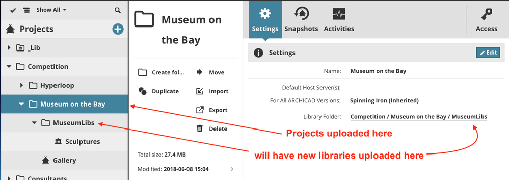

How to use project folder settings to set a default project library location
As can be seen in the above illustration, two project specific libraries are shown – HyperLibs and MuseumLibs. If a project is shared to the HyperLoop folder, it will upload new libraries to the “HyperLibs” folder and similarly  projects shared under the “Museum on the Bay” folder will upload new libraries automatically to their project-specific library folder called “MuseumLibs.” The Library Folder setting for each project folder controls the library upload behavior. Specifically, the “Museum on the Bay” folder was set up as can be seen below:

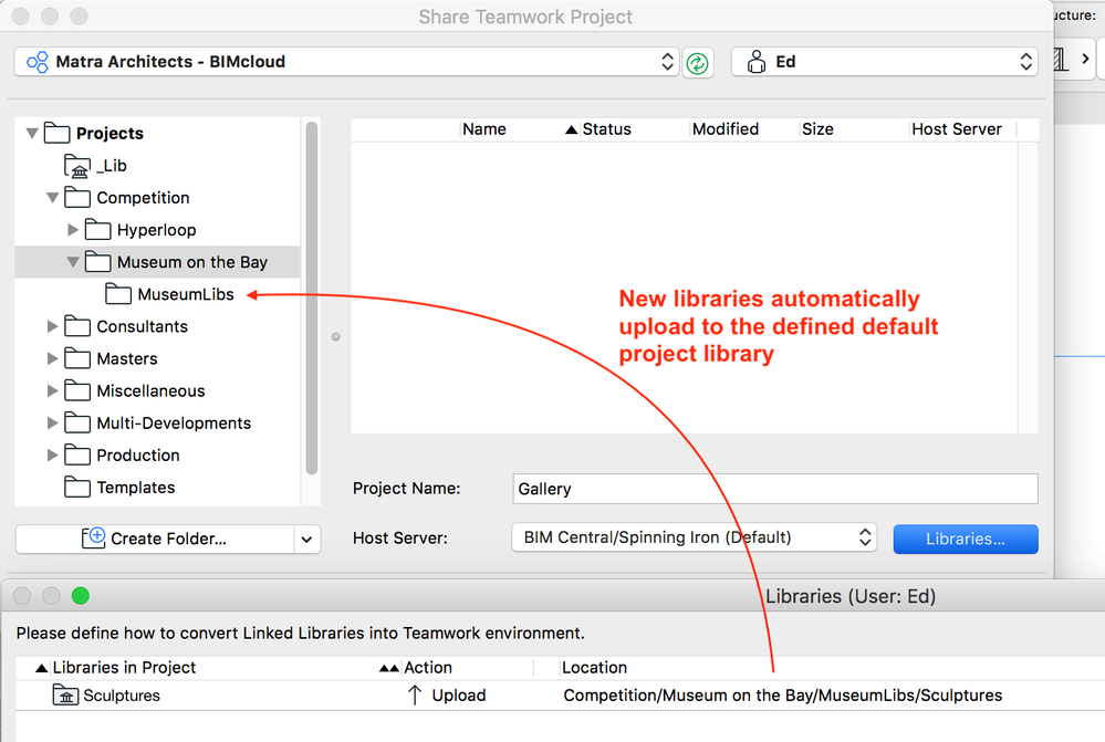

In addition to setting the default project library with the “Select folder” option, there are 2 other options for library folder actions that can be defined for any project folder.  The “Use inherited” action results in any parent folders’ rules being used.   The “Defined manually from ARCHICAD” setting will force the user to choose where to upload any new libraries.
When a project is shared, ARCHICAD fills in the location of where any new libraries will be uploaded based on the action set in the containing folder.   See the below illustration.

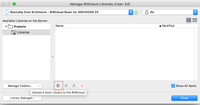

Considerations for library features in BIMcloud Basic
BIMcloud Basic does not provide project library actions in folders and does not allow sub-folder creation.  A logical consequence of this is that the BIMcloud Basic library will never be found in sub-folders and will operate similar to older versions of ARCHICAD.

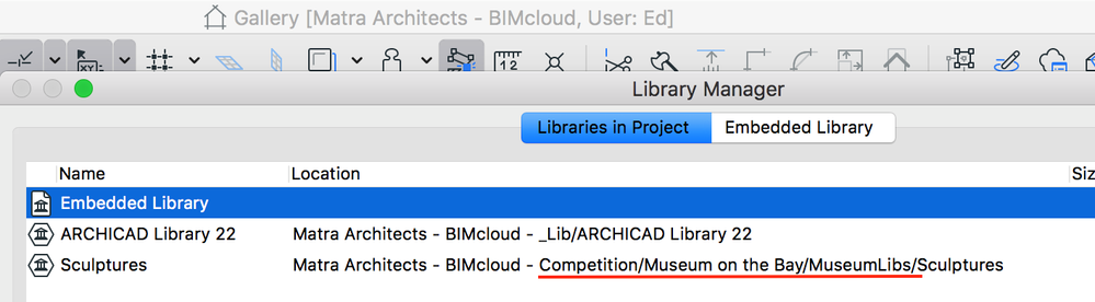

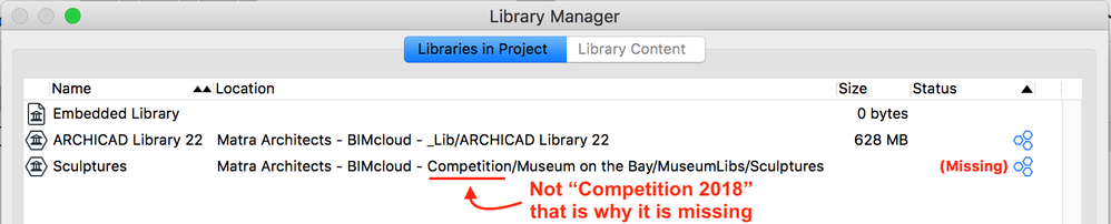

ARCHICAD version 22, on the other hand, relies on hierarchy and rules specified in folder settings of BIMcloud to determine library linkage. This reliance upon hierarchy should be considered whenever folders are renamed. In general, if project library folders are in use it is not wise to rename containing folders.  For instance, below is a project with a library linked to “Competition/Museum on the Bay/MuseumLibs.”   When the containing “Competition” folder is renamed to “Competition 2018” not only will libraries of projects using the MuseumLibs library folder go missing, so also will any library of a project in the Hyperloop folder that relies on its “HyperLibs” project library.
If the folder hierarchy can be considered static from the standpoint of the project libraries, there will be no need to re-link project libraries. Always consider when re-naming folders whether there are project library folders lower in the folder tree.
