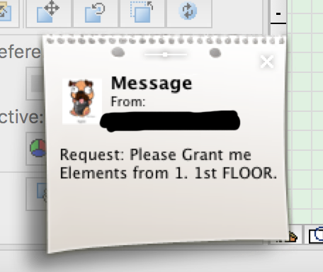

Teamwork Message Pop-ups: Make them stop!
How can I turn off or prevent these pesky little pop-ups (see attached image) from appearing every time a teamwork message is received?
I am happy to have the messages show up in the teamwork pallets "messages" window, but the redundant pop-ups are driving me crazy.
Help me, Archicad Talk. You're my only hope.

Should be in your work environment.
Options > Work Environment> More options > Show New Message Alert in Teamwork
YES!!! Thank you Erwin Edel!
