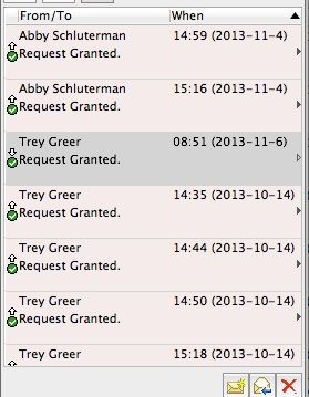

This probably has been this way for a while, but I'm just now posting about it. I couldn't find anything about it when doing a search. The messages in the Teamwork pallet window do not properly sort by date... It would seem that they are sorting by time and then by date.

Hi Millard,
The messages are sorted by the first digit of the Day. I've forwarded this issue to the developers to sort the messages based on the date.
