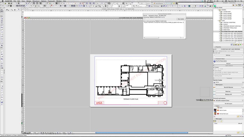

here's the error message I get on two machines while trying to update the viewmaps we have robbed from another TW database file.
see attached screen snapshot.
Meanwhile, I don't get this error message on my terminal yet two of my coworkers do get it.
What does this mean?
How can I fix this error message so my coworkers stop getting it?
Is there a bug fix that corrects this problem?
Where can I find the bug fix if there is one?
Why does this error message happen on certain machines and not others?
Does it have something to do with the local copy of my TW database file that is somehow different than on my other coworkers machines?

You've done more than rob a view, you've linked to a drawing. I don't know what the exact problem is (you've only shown half of it), but do you really need to link to it or could you just copy paste elements in?

I am having the exact same problem, but in a non-teamwork file. Every time I save the file and open it when I get to work the next morning, tons of my drawings are getting errors like the one you show in your screenshot.
I have to open the drawing manager and re-link them.
The other thing is that layer sets are being re-organized and dimensions are randomly switching the direction they are laid out.
Its really getting annoying. I'm the only one working on the project as well.
Is this a glitch?
Could be give some more information?
