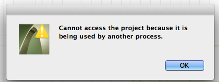

I had teamwork running succesfully in our small office. One computer runs the BIM server and the other is a client. We recently upgraded both machines and with the fresh install I am getting two error messages.
Both these occur when using the client:
When trying to access a teamwork project that exists error message reads
"Cannot access the project because it is being used by another process"
When trying to create a teamwork project
"Error occurred during last teamwork operation! Create project content Failed!"

Hello! Following up on this thread and this other one (http://archicad-talk.graphisoft.com/viewtopic.php?t=35264 ), I have encountered the same problem. Curiously enough it only happens when trying to access our BIMserver from outside the office, using a remote connection. ArchiCAD starts well, gets a license from the keyserver located on the same computer as the BIMserver, connects to the BIMserver (it shows active projects), but when attempting to open any of the teamwork projects, the message appears:
Does anybody have an idea on how to solve this? We are running ArchiCAD V18 INTERNATIONAL FULL (4020), BIMserver is the same version, host computer is a Mac Mini with plenty of RAM, MacOS Yosemite server.

gdlgurus wrote:I've seen this message when a .pln is aleady open on the same machine (would be too easy to say "you've already got the file open"), not sure how that can be happening when you are connecting to a teamwork file.
Are you sure the file was uploaded correctly (can others connect to it)? Just wondering if the file is corrupt in some way.

The ports for v18 are different from v17, have you added in the extra ones? Think it is TCP 1228 and 18008, but worth checking to be sure.
Clutching at straws a bit, no idea why blocked ports would cause this error message.

We received the same messages from only one machine in our office, and were unable to open a teamwork project from the BIM server or share a project from this machine.
This solution worked in our case: Go to users folder/library/application support/graphisoft/twdata folder and delete the contents.
Reopened AC18 and created a simple test project and shared it. When we did this it re-downloaded the necessary information to setup the local TW folder and VOILA all was well.
Might be worth a try.

We were running into the same problem on a single machine and Kirby's solution worked perfectly.
For us the path was "Users/User name/graphisoft/tw data".
