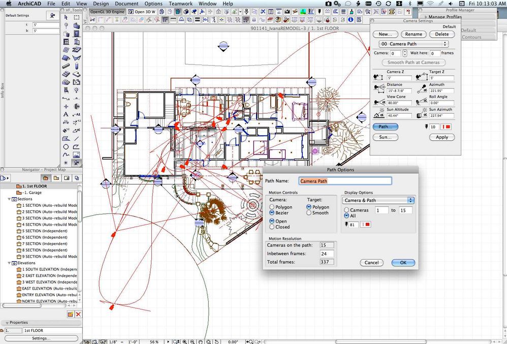

vfrontiers
Make sure you have CAMERA's and PATH selected in the settings (under the PATH button) for your camera set. You will then SEE where the camera is traveling.
The HANDLES at each camera help shape the path on a bezier curve.
Cameras get ADDED IN in a funky way, so YOU need to be sequential about placing cameras... In other words, you can't re-route the path from 1 to 4 to 2 to 3.... Largely they go down as you place them, but I believe if you are on any particular camera, let's say #5, then if you draw a new camera it will be #6 (even if you already had 10 cameras in your path.
See the screenshot below for how crazy a path can get... Admittedly I am using cameras for STILL SHOTS so the path is not important....

rob2218
that's sort of what I start to see when I keep adding camera's.
It seems that the camera's are all "linked" one to the other...and the path it creates gets...well, like in your image snapshot.
I only have two camera's in my "path". I tried to draw a circle, place it in the center of the building and add camera's to that "path" but for some reason..the camera's came in with their own 'path'.
I'm sure I'm missing some step, some toggle, some blip-jip button I'm toggling incorrectly or not...but it's a bit cryptic how the animation works....or at least is setup.

vfrontiers
Note that you can grab one of the handles at a camera and drag it to the OTHER side of the camera to change the DIRECTION of the path... So if you're seeing a FIGURE 8 type path, change the handle of one of the cameras and you'll see the path turn into more of a circle.
Like most bezier curves, the LENGTHS of each half of the handle are independent while the angle is shared by both (halves)...
