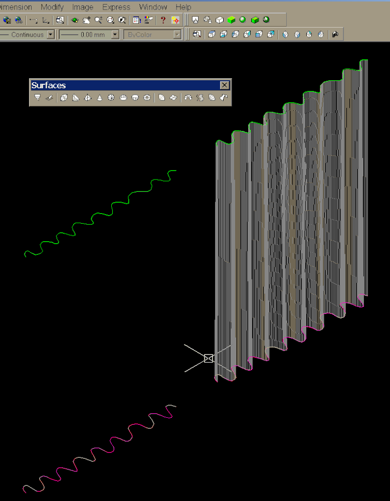

Does anybody know of an AC plugin which works with really usable 3D polylines? I've tried ArchiForma and found out that its 3D polyline is very crude - when drawing arc segments you can only use one drawing method, which is not the best of them, and you cannot use Magic Wand to redraw a polyline from AC.
I want to model a simple curtain in 3D - two polylines and a Ruled surface - it turned out to be extremely difficult.
So I did it in AutoCAD.
I wonder when will AC have these simple functions AutoCAD has since release12 (year 1996 if I remember right) ???

But you see - this is what I don't like in it, and it's the same in ArchiForma. This is not a real Ruled surface for me. Have a look at the picture. (Still AutoCAd, sorry )
Djordje wrote:
I have a feeling that you are trying to literally translate your experiences of one software to another, instead of trying to understand. Never a good method.
AC is my primary CAD application since version 4.5, I use AutoCAD only when I have to do things that are difficult or impossible to do in AC (alas, there are still such things ). I think translating experience from other software is a good, not a bad thing - it broadens your horizon and enables you to see some shortcomings which otherwise you would not see. You never know it existed until you've tried it.

For me the easy way to get the second polyline, is to take the first one, and move in XY the position of some nodes.
This way you are sure to keep the same number of nodes.
On 8.1 you can replace RULED with RULED{2}, for a better control of vector directions. Take a look at the GDL reference guide.
(electronic documentation only)
You will see that RULED command allows you that several nodes of the same polyline are on the same position.
I think it can solve your problem.
It is GDL and it is parametric
