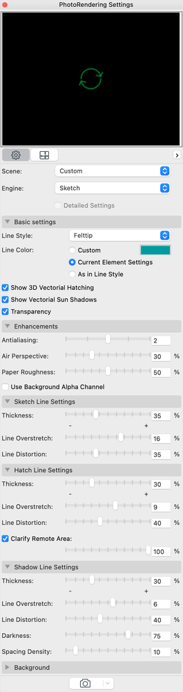

Thanks for your report and input. This is a known issue, DEF-16830, the Sketch Render was left out from Archicad 27 Solo by mistake. It will be fixed in Archicad 27.1.1. In the meantime, please:
  1. Save your work and quit Archicad.
  2. Download Archicad 27 Full and copy the following to Desktop:
    • macOS: Sketch Rendering Engine.bundle and "SketchTextures" folder from
      /Applications/Graphisoft/Archicad 27/Add-Ons/Visualisation
    • Windows:
      • Sketch Rendering Engine.gmx and "SketchTextures" folder from
        C:\Program Files\Graphisoft\Archicad 27\Add-Ons\Visualisation
      • OpenGL Engine.gmx.mui from
        C:\Program Files\Graphisoft\Archicad 27\Add-Ons\Visualisation\en
  3. Move these to the respective locations in Archicad 27 Solo folder.
  4. Launch Archicad 27 Solo and now Sketch will show as an option in the Photorendering Settings palette.
I hope this helps.

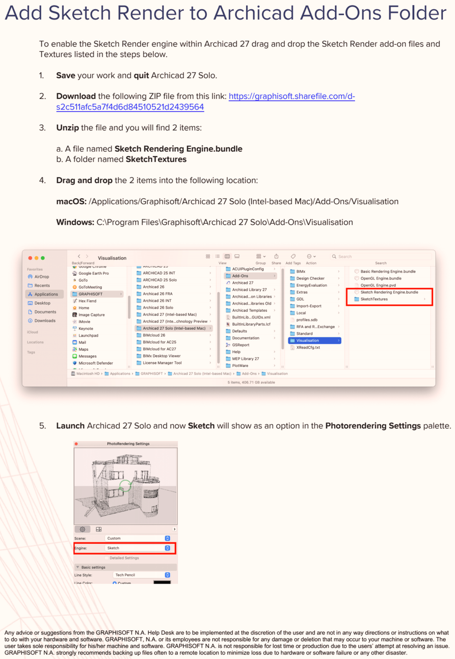

I have not tried this, but here is what Graphisoft sent me as a temp solution. Here is a link to DB (PDFs not allowed here and link not condensed for trust reasons) and the email I just recieved.
[Moderator edit/note:  The PDF is attached to this post now.  PDF's aren't allowed as in-line insertions, but are allowed as attachments.]
"After your ticket we noticed others having the same issue, started looking into why that was happening. It is still unknown whether this was a purposeful, or an accident on the development side, but we were able to create a workaround solution. We have already tested it and are able to confirm that it works. Please see the attachment below."
https://www.dropbox.com/scl/fi/tcd674kbjjv3yil1geikd/Add-Sketch-Render-to-Archicad-Add-Ons-Folder.pd...

Thanks for posting this, Trioso!  Can you, and others, confirm that the downloaded add-on indeed does work with 27 Solo?  If so, then we can mark this issue solved (sort of ) for now.   For affected 27 Solo users, please download the PDF from the DropBox link above.  But, here is a screenshot for posterity...  Being a screenshot, the link doesn't work, so use: https://graphisoft.sharefile.com/d-s2c511afc5a7f4d6d84510521d2439564

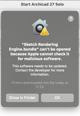

Florin Luca
I got the same result like @Trioso , same dialog box plus this message before AC27 Solo loaded:
 I moved on and AC27 Solo loaded. I checked for the Sketch engine and it wasn't there. I did check the Add-On manager and it showed this:
It is the same out of date message I got when I tried to get creative and copied the same files from the AC25 Solo into the Add-on folder of AC27 Solo. It is possible that the files we were sent are actually out of date or we are not using the same regional version (or we weren't sent the correct regional version) – just my guess.
