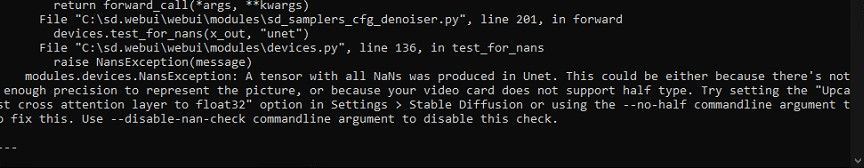

When I run the AI engine in the Archicad AI Visualizer screen, there does not seem to be any problem, but when I click the generate button, I see an error in the cmd screen as in the attached screenshot. The video card of the computer I use is GTX 1660 Ti. So I don't start it in High VRAM mode but I still get this error.

hey,
1660 ti's have 6gb vram, 8gb is the minimum requirement for the program.
hope this helps.
Cian.
