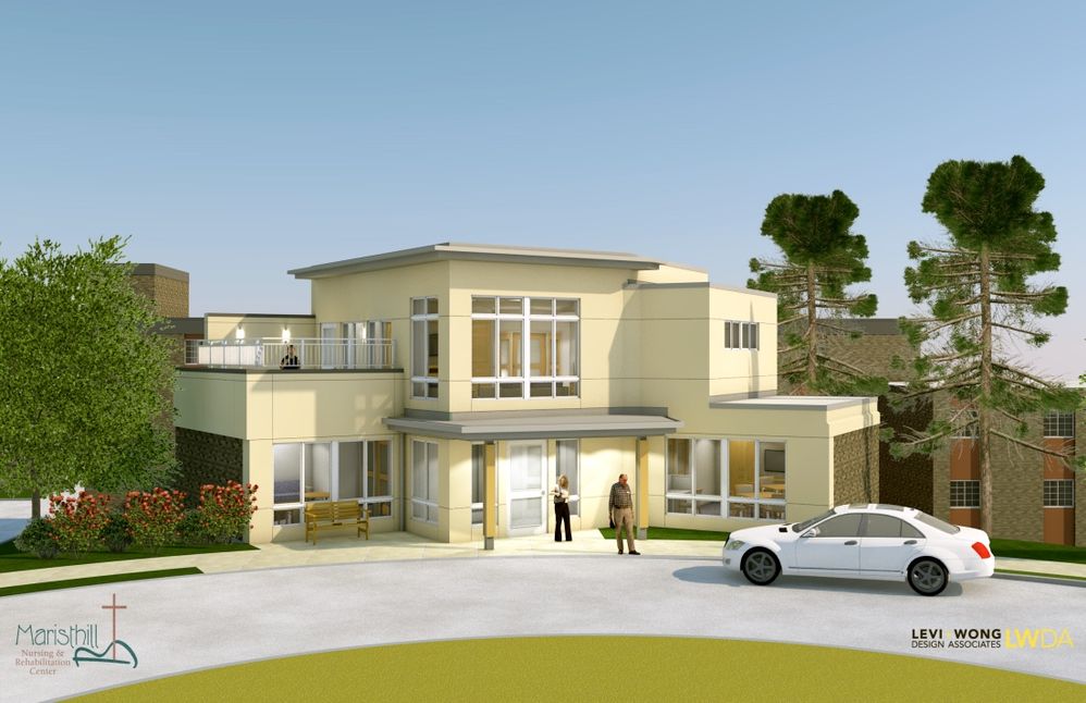

I would disagree about the speed. I attached an image that was originally 11x17 and took about 1hr.
I think its fast and you need to set settings correctly.
You cannot make a 24"x36" Rendering in 1 minute. IES lights, special effects, and grass will make the renderings much slower.
Never render the entire scene or model, use the marquee to minimize the scene as needed.
From my understanding Cinerender is basically Cinema4D version 13 or 14 engine modified.
If you want to farm out your renderings then buy Cinema4D to farm them out. If you buy studio you can use an unlimited amount of computers to render your scene, even better make cool animations.
