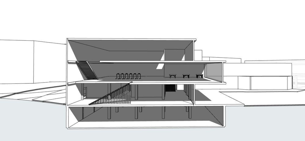

Hello everyone! It's my first question topic, so i apologize if any rules trespassed by me and forgive me about my poor english.
So my question is, is there anyway to render a high resolution picture of my model as exactly i see on 3d window. I'm using "white model with shadows" option and i want to render this view.
I have tried white model effect but it doesn't show edges and white walls get lost if the background is white too.
1 REPLY 1
Steve Jepson
It is possible that you don't need a rendering for that kind of view.
Changing the background so it does not have a white background will help if it is a White Model with Shading you want. Also, if you change the 3D window size to as large as you can, then save the view as a 3D Document you will have very good sharp lines and you can adjust the size/scale of it in Layout. If you have a very high resolution screen you might even be able to get an acceptable screenshot of that view.
