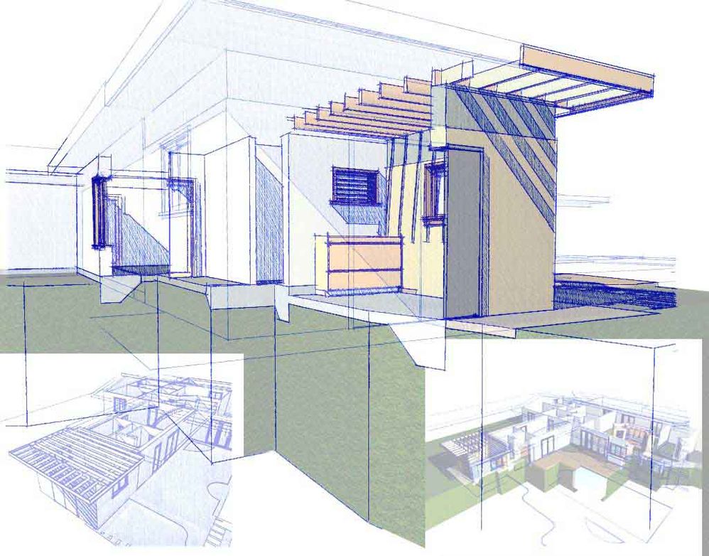

I've posted some images of how I've set my sketch settings on another thread. I'll see if I can locate them.

here's the image that it produces.
i'll see if I can't get an explanation soon of the settings.
.....seem to be having trouble sizing down this image.
what's the best way?
