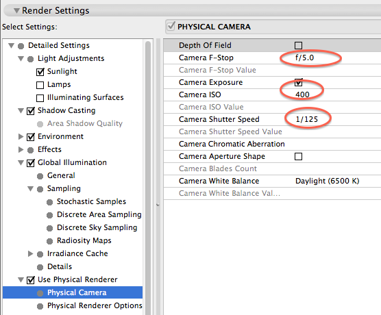

If using the Physical render, it uses camera-like settings. See attached for the default settings for the Indoor Daylight Fast (Physical) scene as created by GS. Just as a real camera, you probably have to boost the ISO and/or use a lower f-stop and/or use a slower shutter speed to get more light into the virtual physical camera to brighten up the image.

I just took a look at the Indoor Daylight Fast (Physical) scene settings and verified the darkness you saw, Gus. And, changing camera parameters didn't fix it.. was still black outside the windows.
Graphisoft made an error in setting up this scene it seems. It should have only turned on the physical renderer, but it also changed the intensity of the Global Illumination settings for the worse.
The interior 'fast' settings had Detailed Settings > Global Illumination > General settings of 200 for primary intensity and 400 for secondary intensity. The delivered 'physical' version of interior fast had 120 for each. Not enough light bouncing around.
You can either select the physical settings and adjust the GI to 200/400 and then further adjust camera settings... There's a balance between over-exposing the sky and other exterior elements and having enough exposure on the interior.
Or... try loading Indoor Daylight Fast and then, with detailed checked, check the box for Use Physical Renderer and try the attached values for f-stop, etc and adjust from there, clicking the preview image for a quick preview before doing a render.
