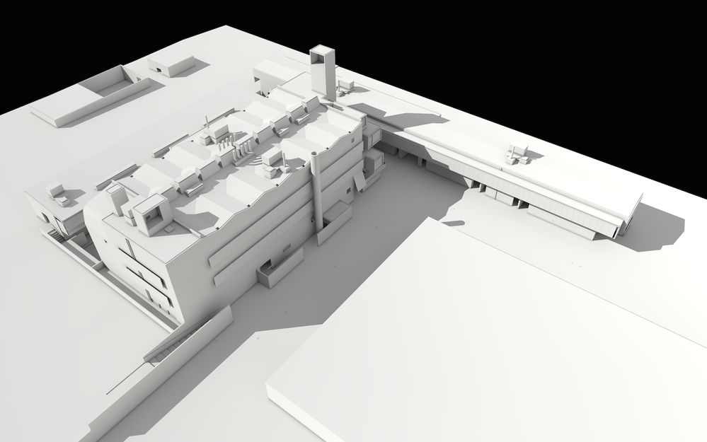

Eduardo Rolon
and a white model were nobody misses the standing seams on the roofs.

Brad Elliott
OK fast with ambient occlusion is nice. Why is this not the pre-set? I don't know that I will look at anything else at this point.
As for white I really like the idea but this is what I get. Very moody which is not how I want my clients.
