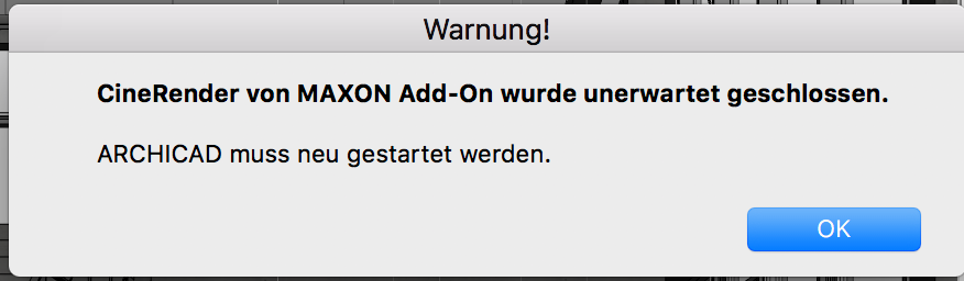

I'm using MacBook Pro 13, 2016 (Touchbar Version) and Archicad 21, Build 4022. Since yesterday each time when I render in Archicad, a notification comes:
CineRender from MAXON-Addon quit unexpectedly
Archicad must be restarted
(I translated it from German )
My Macbook was running High Sierra, I tried to downgrade to Sierra, and the problem is still there.
I tried to call Graphisoft Hotline, but they don't accept calls from cellphone, which is a bit ridiculous...
It would be great if someone could help me, my final presentation is already next week

I'm having the same problem with the same error message, running macOS Sierra Version 10.12.6
Any help would be much appreciated.

Hi Jon, I just took a look around the internet and maybe it's because the CineRender App can not be started with Ac21 (I checked the Activity Monitor and there's no CineRender)
So I tried to install Archicad 20 to check if CineRender works, and it works.
Then I had an idea maybe CineRender of Ac21 depends on Ac20 (because for me Ac21 is just no more no less an extension version of Ac20, it came just shortly after Ac20 )
I installed Archicad 21 (keep Ac20 installed), tried to render and...voila CineRender works again
It sounds a bit strange, but you could try

No version of ARCHICAD is dependent upon any other version. Every aspect - from preferences/Registry to all executable components is unique and self-contained. There is no concept of 'extended versions'.
What you experienced is likely due to an installation, or update installation, error which the clean install resolved. 😉

But the point ist, the problem appeared in Ac21, i reinstalled Ac21 and the notification that CineRender quit unexpectedly still pops-up everytime i tried to render.
The problem is solved when i installed Ac20 and then Ac21
but I know you are right, because i have only Ac21 on my iMac, and everything are alright there, maybe this is only a problem with the new macbook pro
