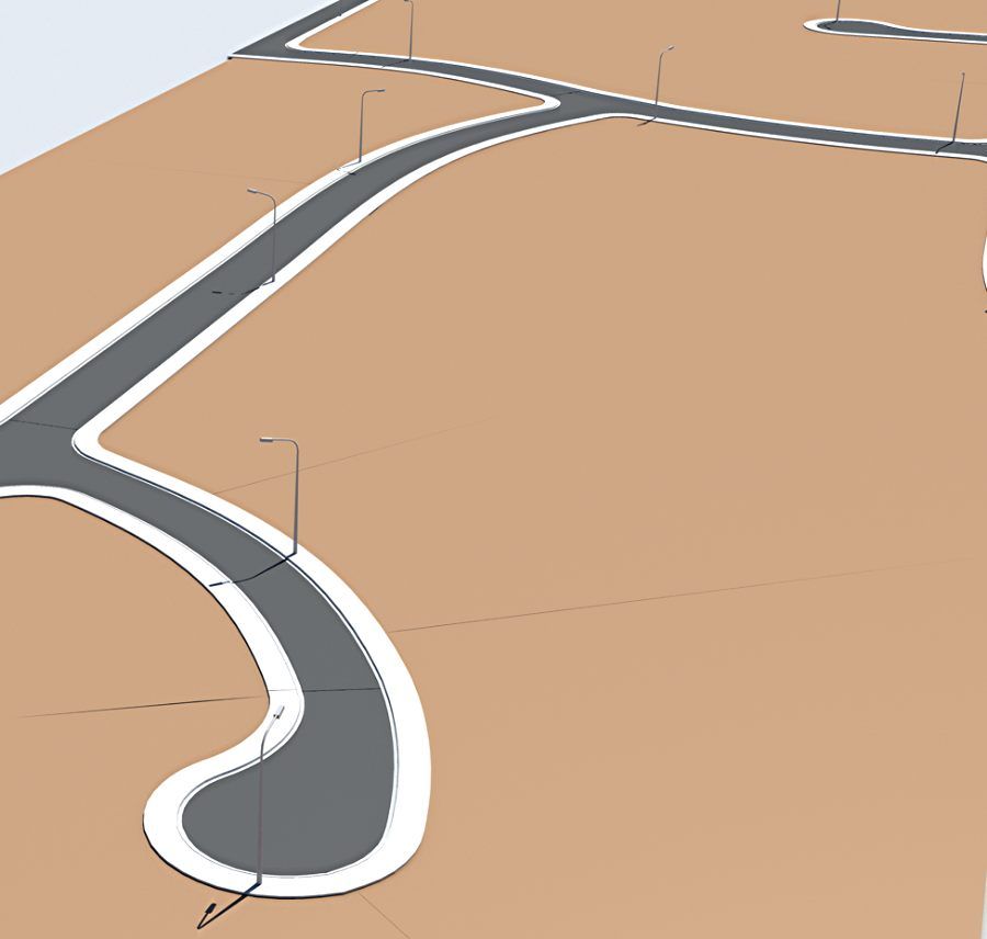

In setting up a model of a neighborhood. If the site is for all intents and
purposes FLAT, you can get away without any add-on. Just use ArchiCAD and
version 10's new complex profile tool. Draw a section of the road, include
the curb and sidewalk. Give the different fills a different material such
as Paving - Curb and Sidewalk. Click, click and click your way around the
supplied civil drawing. At intersections use a slab with just a curb and
sidewalk complex profile on the border. Add invisible roof objects and the
solid element operations for handicap ramps at intersections. Add lamps and
you are good to go.
The following two images show a birds eye and a close up.
Here is a close up of a curb cut at an intersection, created in ArchiCAD. Dosch Design Nissan Car model added in C4D.
edit - actually a Toyota Celica
