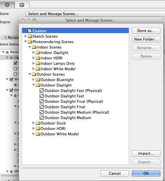

See the attached to open a pre-defined (by GS) 'scene' with fast settings and see if you get satisfactory results. A scene is just a named collection of all of the many CR settings. I don't believe the predefined ones are necessarily good, but provide a reasonable starting point.
