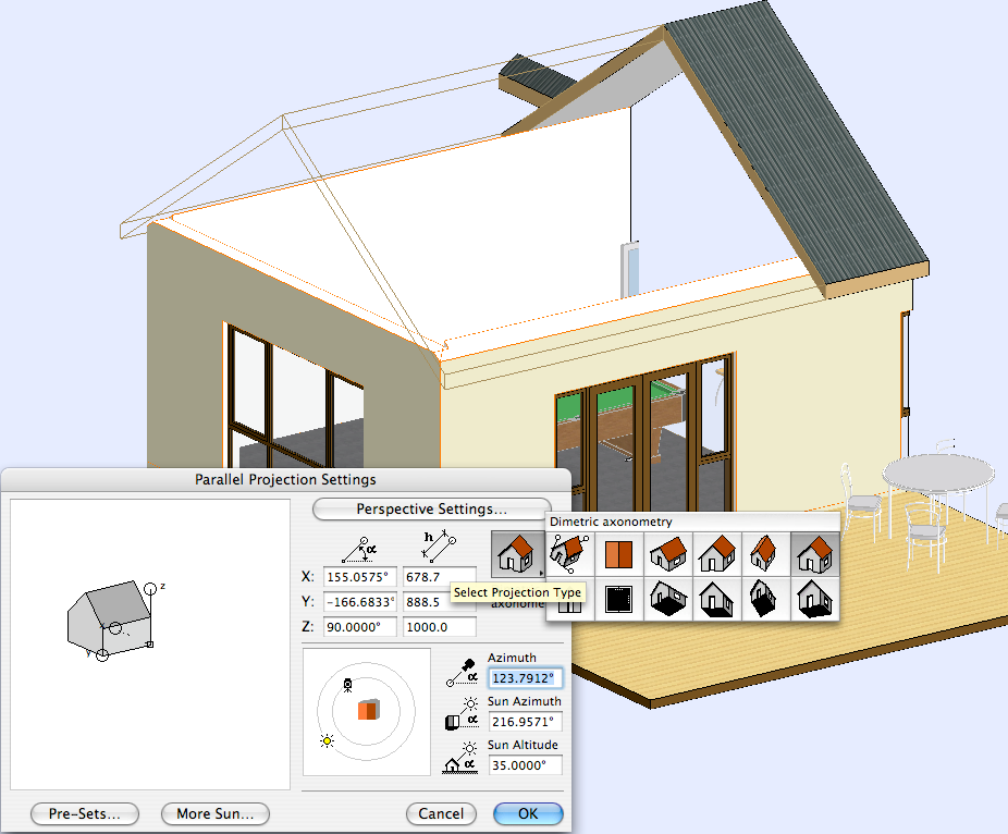

Try one of the pre-sets in 3D Projection Settings. You can adjust the angle with the normal 3D navigation methods, then save the view so you get the same angle next time you want it.
Also, the wireframe method for see-through elements only works in Internal Engine or OpenGL windows, but will be completely invisible in Lightworks renderings.

Thanks s2art!
That worked great
