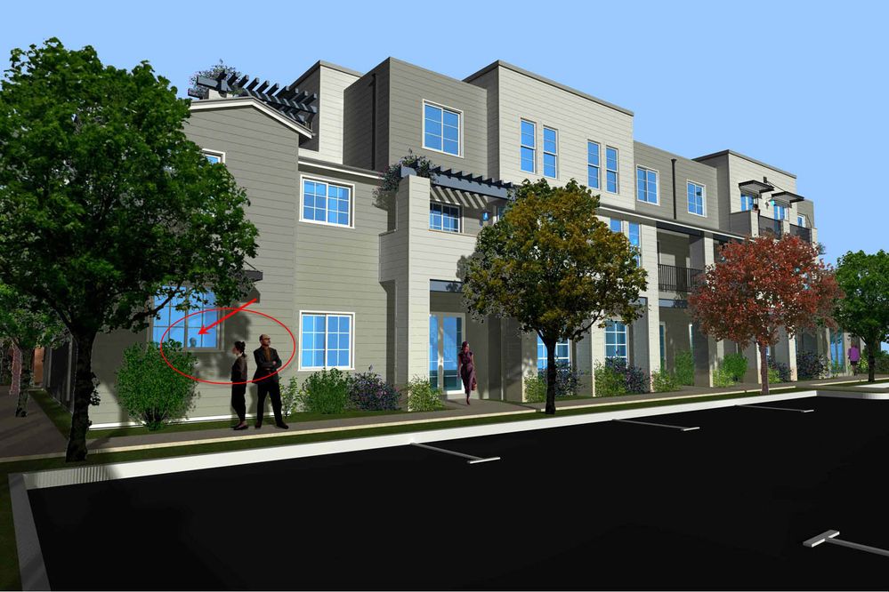

I know this may not be the correct forum for this but here goes; is there a way to make the reflection in windows map correctly the rear of the billboard object being reflected? This was rendered in Artlantis R, but I believe it will be the same in LW. This is a typical condition we have that repeats itself many times.
Thanks as always,
Scott
