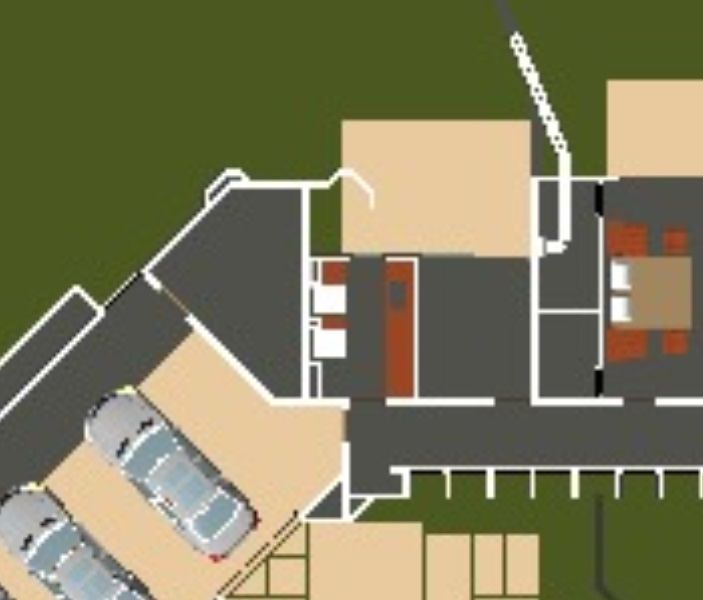

After placing on a layout it looks like it's way too pixelated and there doesn't
appear to be anyway to add dimensions.

From the 3d window "top View" I'm right clicking and using the "New 3D Document from 3D" - I give it a name and press create. It says it's generating the 3d document and calculating split polygons then it comes up as a plan view
with the grid display on. there is no color here and the view is 2d only
see screenshot below. If I go to the 3d window it takes me back to the 3d view that this was made from. I don't know of anyother way to save this except to do a save view and place on a layout. I need a high resolution model colored plan that can be dimensioned and placed on a layout.
I've added another screenshot below to show the view I need to work with.
Don't know how the dimensions are going to show, but one problem at a time I guess
This is what I need to place on a layout, but everytime I try to do it it's too pixelated.
