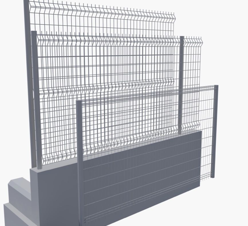

excellent way of doing it, gets the best of both worlds.
did you tile the fence nicely?
a pic would be fantastic.
See attached picture of 3 versions:
1. Complex Wall Profile
2. Object Made from Complex Wall Profile
3. Surface Texture made from Object.
For the surface you need to create a image that is the correct size for repeating intervals. If you change the height you will need to made a new texture to map.
