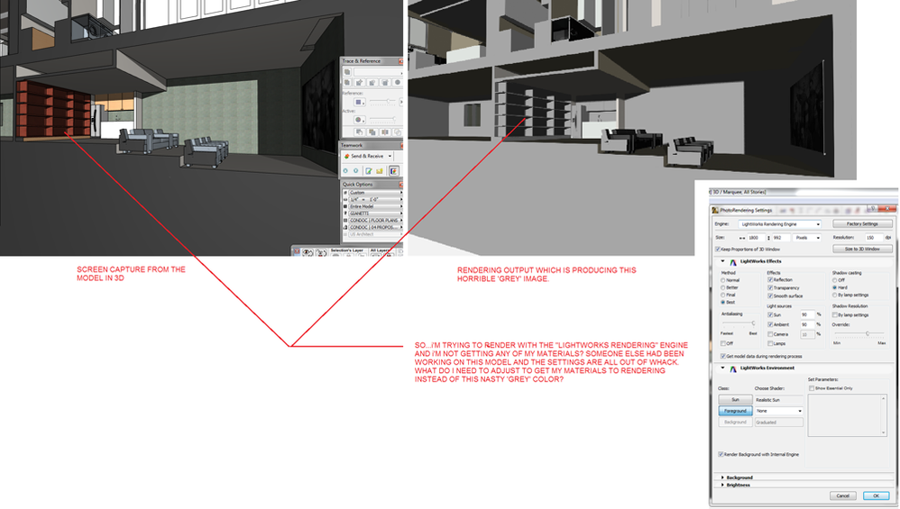

see attached.

The settings that we need to see aren't showing... but you have one of two problems:
Either the 'white model' setting has been selected under the detailed settings (try selecting a different rendering scheme and see what you get ---only need to look at the preview image)... or...
Your materials have gotten hosed... the OpenGL material has absolutely nothing to do with the rendering material for CineRender... just as it had nothing to do with the material for LightWorks in years past. The factory materials are delivered 'coordinated' so that the materials pretty much match... but it is entirely possible to show wood for OpenGL and white paint for the CR setting. If trying a different rendering scheme doesn't show the materials... check the surface settings...

More sorry... I obviously did not read that you said "Lightworks". So, my step 2 of your materials being hosed is the most likely issue.
Check the material for those shelves and look at the OpenGL appearance vs LightWorks appearance.

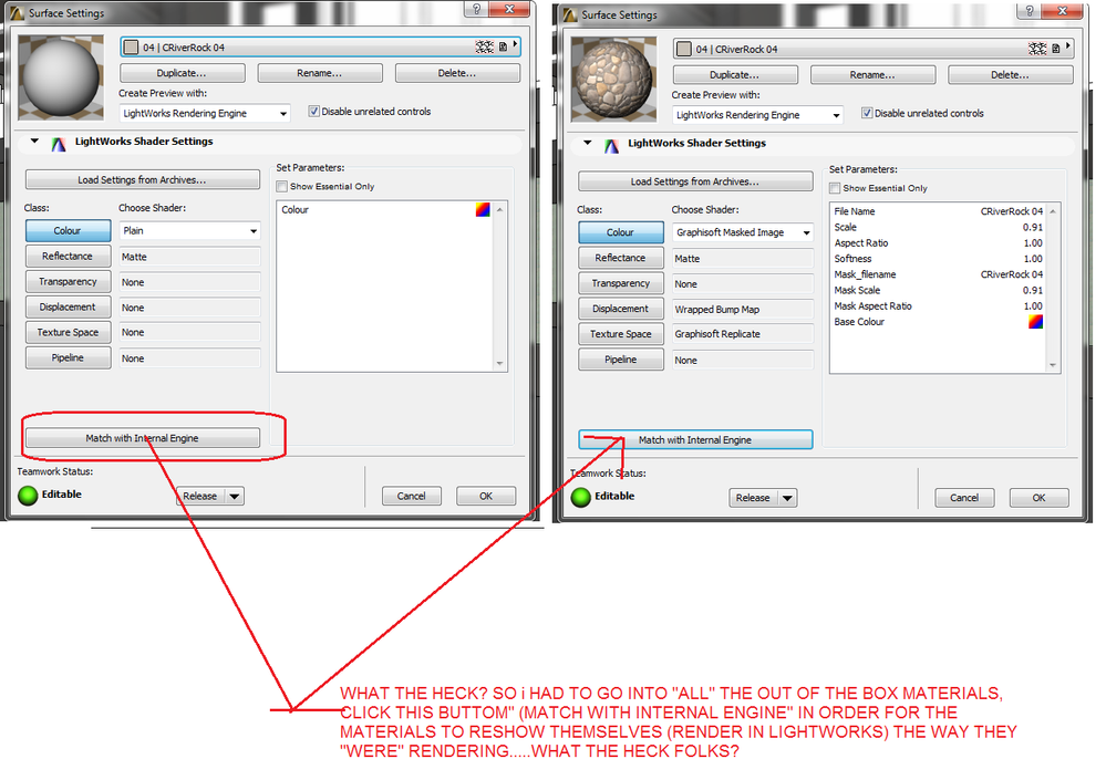

here's what I've had to do.
Go into EACH and every material we have in this project...then do the "match internal render engine" to each one...then simply exit the materials dialogue box and hope it "stays" put.

rob2218
they ALL (all the materials in this project) have that "grey" appearance.....hopefully the "match internal engine" solves that issue....I hope.

Karl Ottenstein
Moderator Emeritus
Either something corrupted your attributes (the factory attributes DO match out of the box) - or someone intentionally made all of those gray. Very unlikely (not impossible - but never reported to my knowledge) for the LW materials to go 'blank' on their own.
[There was an attribute manager bug when the LW engine first came out with AC many versions ago (cannot recall which)... that was fixed in a hotfix... but which caused some corruption similar to this. But, that was years ago.]

rob2218
it sucked....had to enter EVERY material on this job and match the internal render engine......geeez...I don't think anyone actually went in there to do that intentionally but...what'evs.....

Karl Ottenstein
Moderator Emeritus
Sorry I got tied up and didn't write more sooner... but you should have been able to use Attribute Manager to overwrite all of those materials with materials from a working 17 project or factory template... if the material attribute numbers lined up for easy over-writing at least. Something to keep in mind if it happens again.
Quite the mystery why it happened to you...Bummer.
