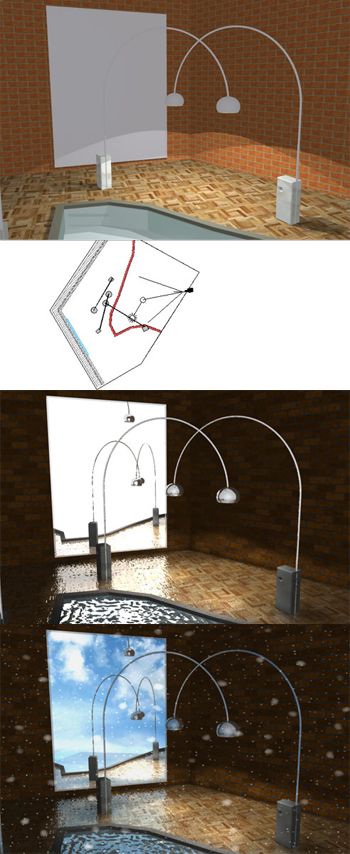

However, the mirror will not take light from the sunobject, and reflect it from the mirror surface and cast in on the floor. Is this possible with a setting I don't know about?
This is an old LW test.
1 = Internal Render
2 = Floor Plan
3, 4 = LW test
CU mirco
www.3dsmile.it
