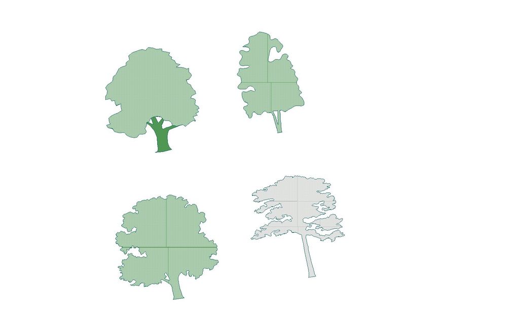

I am experimenting with a rendering techinique and want to include transparent and translucent materials. I have created some different transparent materials with different transparency and color and then I have created some tree forms from slab tool and applied a transparent material to get desired effect. Sometimes the trees show grid lines acros them. When I apply the material to a large slab or wall there are no lines. Am wondering if the complexitiy of the tree form is causing?

Any other ideas? Any possibility that the complexity of the slab perimeter could have an effect?

Seems like there is a fill applied to the material you use. Give it a check!
Something else came to my mind:
AC doesn't like slabs with zero thickness, so if you have used such one, it could be the problem.

I did experiment with different GS glass materials and made the material I used from the GS glass material. Did experiment with thickness and had my slab thickness set at 1/4". Thicker did not make any difference. So far have found that the complexity of the perimeter of the slab seems to have a direct effect. It is odd though that I can apply the same material to a vehicle with clean results.
