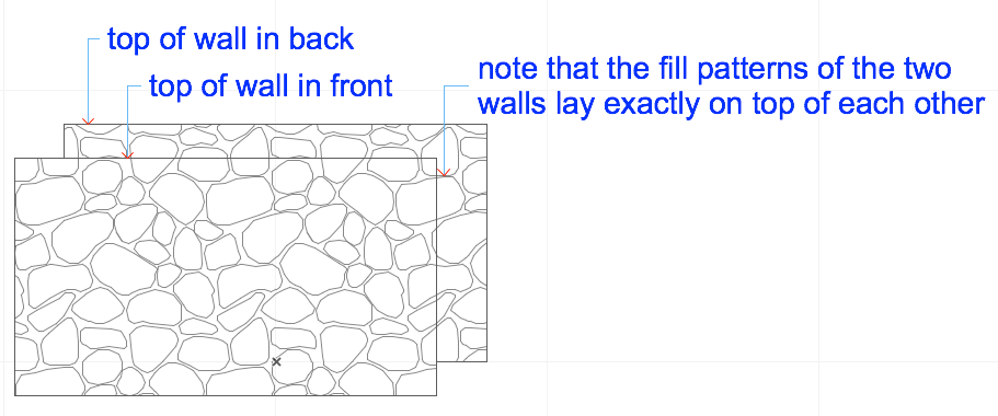

I can verify what Eduardo found. Draw two walls one left to right
the other right to left and there is no shift and if the walls are
drawn one above the other there fill patterns align exactly.
Drag both walls by there center points to align with the project
origin and the fill patterns of both walls still align. This is true
for both AC 12 and AC 10. I also checked if the fill patterns
were symmetric about the the project origin and they are
for both versions. So it seems true that 3D vectorial hatches
are drawn with the fill origin corresponding with the project origin.
This is exactly like a 2D fill pattern drawn "linked to project origin".
When the fill is dragged the pattern shifts within the outside contour.
Peter Devlin

And does it also stand true for some kind of river rock hatch? Because the fills in Eduardo's example look awfully symmetrical!
Cheers,
Link.
Hello Link,
I did what you suggested. Using a river rock material
and you can see the result. Please see attachment.
Peter Devlin
