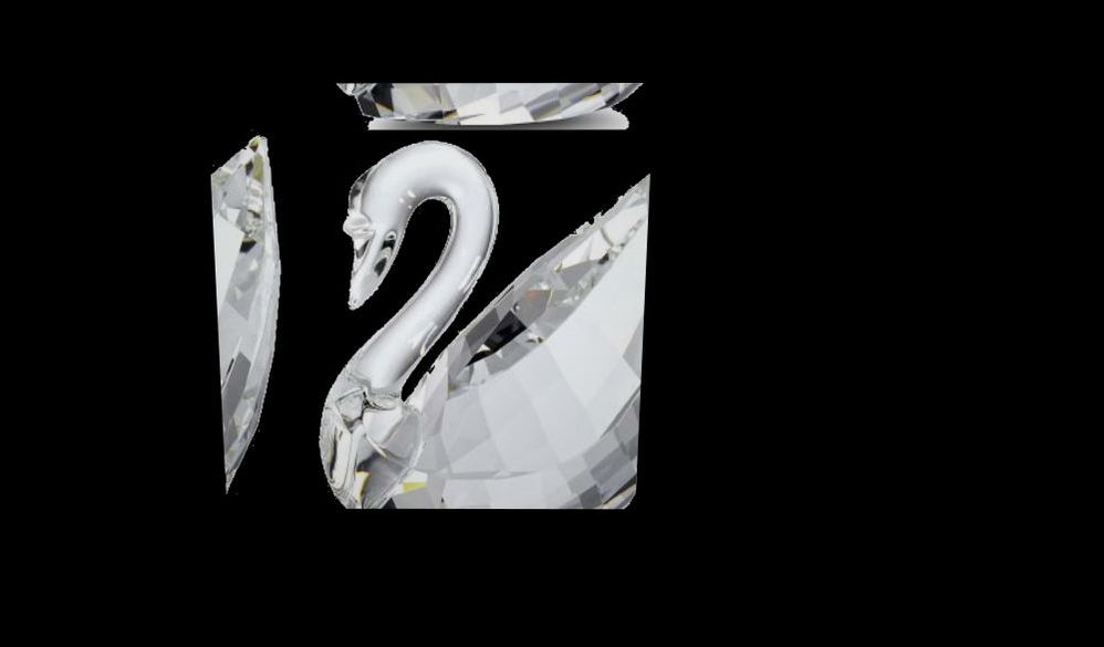

I am putting a custom lightworks material on an object but I don't want the material to tile. It seems to be tiling by default.
Does anyone know where I can adjust and fix this issue? see attached img

jenhudson1982:
It looks like you need to change the point at which the material tiling starts (assuming the material is the correct size for the object). To set the start point, use the Align 3D Texture command. If that is not the issue, post more information/images about the problem.
