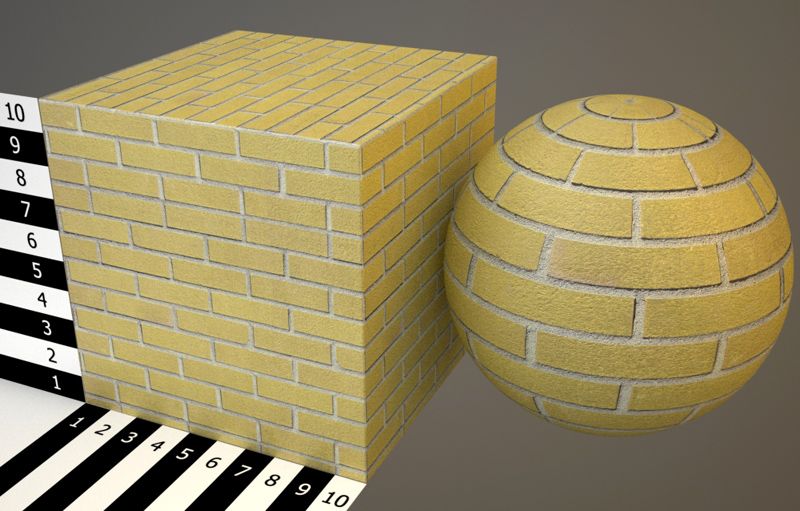

HTH, below is my quick try.

hi tigr thanks for helping! can you explain how you did the maps or even better make them so i know how they should look? I have made a tile-able texture here http://www.lusica.dk/Mursten-diffuse.jpg wich i would like to make bump and roughness maps for. Any help is appreciated
Sure I could just send you the maps but I think you'll benefit more if you try to do it yourself. It is 5 min job and next time you will need no help.
I have no CG background, I'm rather hobbyst so my approach might be wrong but still, it works great in everyday archiviz and only that matters.

1. Diffuse map - colour map of material. Make sure it is seamless and does not have any noticable shadows (like 90% of free textures have) Otherwise it will look fake if the lighting direction/power won't match the one in the map.
2. Bump map - grayscale version of Diffuse map. More gradients = stronger bump. To do such a map you need to go to:
Image -> Mode -> Lab Colour -> Grayscale -> RGB
Now you can use PS tools to clean some areas and alter others. Here the most bright should be the brick face and the darkest - mortar.
3. Specular / Roughness map - altered version of Bump map. More white = more specular. Now it is up to you what areas and how much reflective you need'em to be. Usually I do this:
Ctrl+L (levels) -> move left slider a bit to the right / move right slider a bit to the left -> judge the preview. This will add more contrast to the map and alter the reflective areas of the map. Roughness map is usually inverted version of a Specular map, so you don't even need to make one, Maxwell has such option on the fly.
Hope that was clear enough. Have fun.
Thank you for your time tigr! i have been experimenting with it, and now my photos look very nice!
Glad I could help. Don't hesitate to post your results, and I will get myself a beer. Cheers
