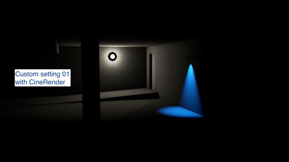

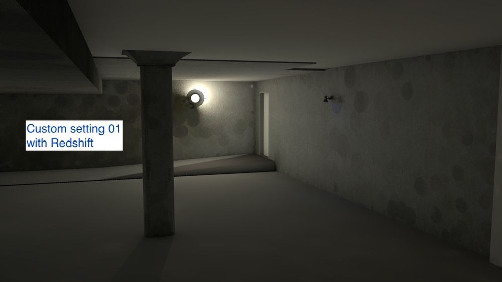

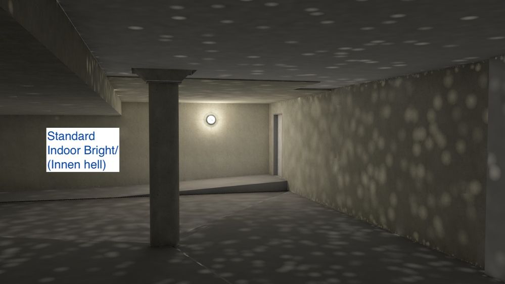

Hi there,
I tested new rendering settings (>Att.)
>1. was in Standard settings "Indoor bright" (ugly clouds)
>2. was in custom setting with Redshift (without global lightning)
>3. was in custom setting with CineRender (same settings as with Redshift)
> WHY is the rendering sooooo different ?

Karl Wir_n
Standard render engine and Redshift do not work in the same way, as you noticed. All material settings do not work in Redshift. Same thing with lamps,
My tip is to choose one of the render engines and do test renders, changing one parameter at a time, until you are happy with the result. Make sure you check the "Detailed Settings" checkbox so that you access all settings.
Maybe you should start with getting the lighting right first, then do the materials.
Good luck!
