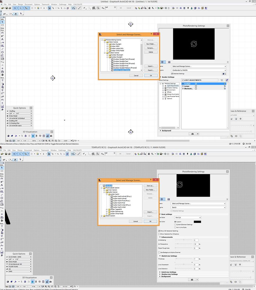

When i open my archicad 17 template in v18, and open the rendering settings, all of my scene names are not in english. if i open the archicad residential template then it is fine. is there a setting i have to change for this?
see attachment

so here is the craziest part. drawings created from that very template, but only some, are in english. so bizarre.
Can you export those Scenes from the German, then import them into the English and save that as a Template?
well i exported the scenes from one of the drawings that has them in english. sometimes the template changes them when i draw the house. not sure what i do that has any effect. but when it does change them i import the english ones. just wish i knew why ha ha.
